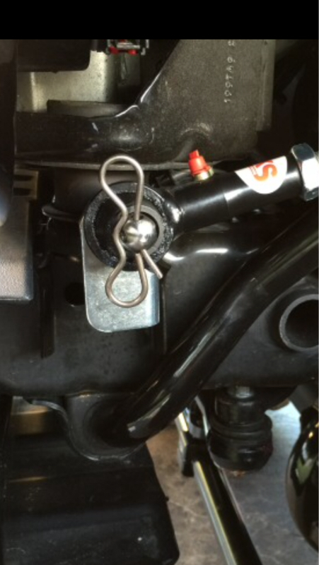

I've used the JKS quicker disconnects for 3.5 years now. They work nicely. I hit them with grease from time to time, but typically when I'm hitting other components, so it's not an extra hassle. Also, once disconnected, it's not like that sway bar just droops down. Mine stays put right where it was and doesn't move during wheeling, and I completely remove the link with 2 pins, so there's nothing to strap up/hold in place. I'd love to have the convenience of a Currie Antirock, but have a hard time spending the money for that added convenience.

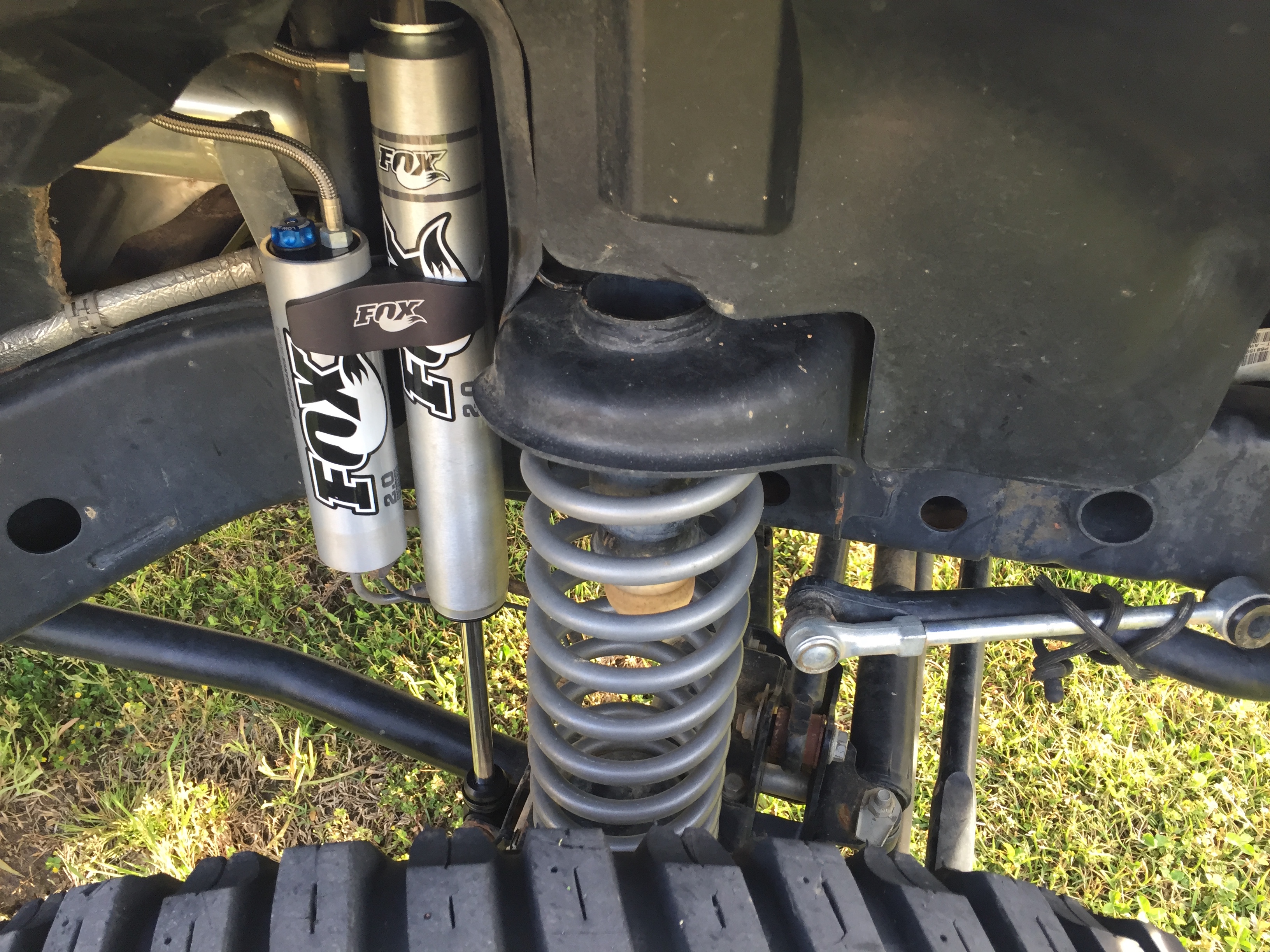

Check out the TeraFlex disconnects. They include a keeper to hold the swaybar up out of the way. You can buy the keeper from TF separately or get it with new links.

Thanks. I may just call TF and ask them about rubbing issues. It sounds like they have been addressed along the way. I do have some TF products on my rig and like them.

If mine moved at all I would, but in 3.5 years that sucker sits right where i leave it when I remove the links. I'd think if it was dropping down easily when the links are removed, it might be time for new bushings. I also find just removing the link completely to just be easier than removing one end and either strapping the other end up or installing a new peg to hold it in a disconnected position. The knock on the JKS quicker disconnects that I can think of is they are a little pricey for what they are.
