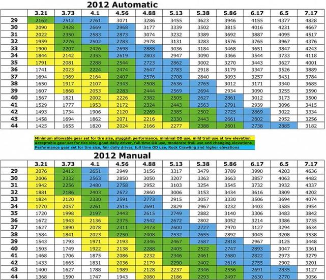

Auto or manual?

Originally Posted by SpicedCrusher
Auto or manual?
Attachment 550156
Auto transmission. The chart you posted is a little different that another one I looked at. This one has everything geared lower (numerically higher numbers) than the other chart I reviewed. Interesting...

The charts for 3.8 and 3.6 are different.
I just noticed that on the chart that was posted. The one I had previously looked at put 4:56 right in the middle for 35s.
You also need to know that the chart is based on actual, mounted and under the jeep tire size.
Most 35s measure closer to 34s.

Oops my bad. Yes the chart I posted is for 3.8 I see you have a 3.6
I'd go with 4.88s. And as Planman said most 35's are actually closer to 34"
Name:	2012 Gear Chart.jpg
