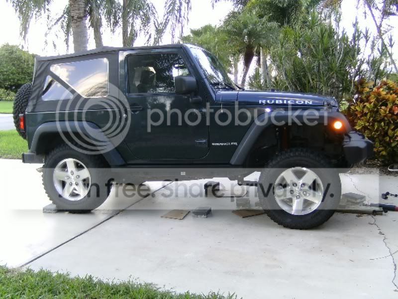

I'm in the middle of installing a Rancho 4" sport lift. It is quite a bit more work than i was expecting, but I've got the front suspension done, except not torqued down yet.
take that, factory rake!
anyways I'm putting on new 35" wheels/tires, but they won't be here until later this week. If I install the rear lift, and torque everything down with 32" tires will I need to loosen and re-torque everything again when the new tires come?
Another way to ask the same question is: can i go from 32" to 35" without adjusting any of the suspension/steering components? I don't want death wobble.
