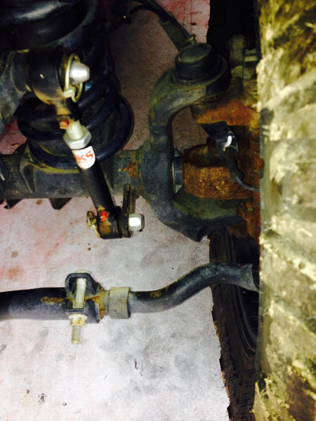

i run with the JKS quicker discos. Haven't had any issues with them. Super easy install. Easy to disco and reconnect (if on level ground)...i really like the fact that they are adjustable. the only thing that bothers me is the top mount/pin sticking out toward the tire. Have to make sure the sway bar is secured and level when disconnected. I always have it in my head that it will break lose and I'll end up destroying some rubber.
here's a pic for ya
