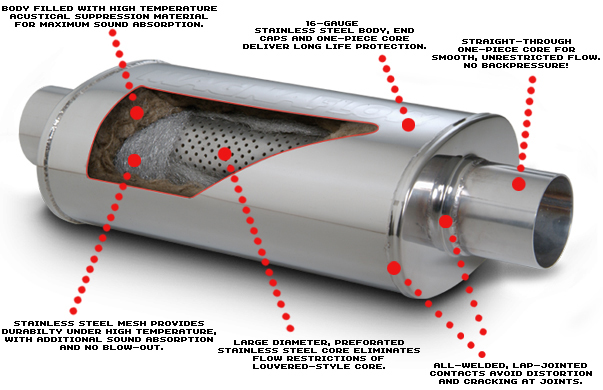

Originally Posted by rsmwrangler
A muffler change won't do much for performance, though when i removed mine, i could've swore she felt more peppier, I went with a Magnaflow muffler, and had my local muffler shop do the welding job, that setup was fairly quiet, barely louder than stock, so mellow that i had the factory resonator deleted as i was actually looking for a tad more noise, and while it makes more noise than stock, it's not obnoxiously loud the way it is, even with the res deleted.
Thanks! This is pretty much what we're known for, for the most part, though some of our off-road and competition/racing cat-backs can be pretty loud. Our typical street systems and universal mufflers do a good job of absorbing sound at idle and cruise but adding significant volume as you open the throttle. When quiet or loud, though, you get a nice, smooth deep tone regardless.
But the key point for the OP was wanting a livable volume with improved flow. Our universal mufflers are all straight-through with a perforated core, which means improved exhaust velocity and more power. Power gains from an entire cat-back exhaust top out around 10 percent (and that's typically high-power applications) so a muffler probably won't add gobs of power, but sometimes an extra pony or two in the powerband can make just-enough difference.
