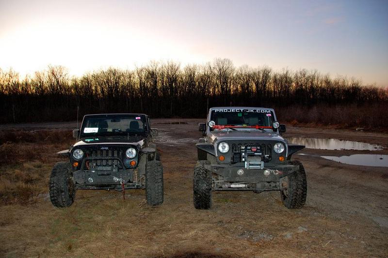

the jeep on the left is mine it has 3.5'' of backspacing and the one on the right has 4.5''

Originally Posted by pbloom95
Attachment 250991
Cool thanks for the pics. So 4" will be somewhere in the middle. They should look good and not stick out too far.
