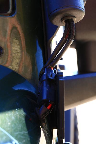

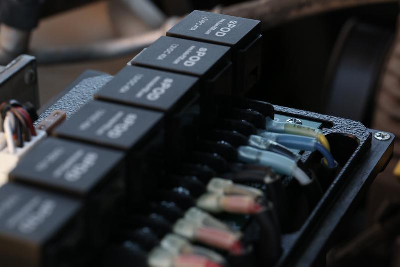

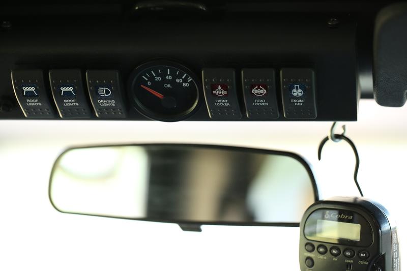

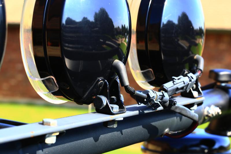

It would be helpful to know specifics of the rack. I have an MBRP rack with the optional front extension. I drilled a hole in the curved sheetmetal plate just driver's side of the hood cowel and put a rubber grommet in there. The rack tubing comes to an end there and has a plastic cap in it. Drilled hole in plastic cap and put another rubber grommet. Ran wires from the sPOD, through the fender hole, through the plastic plug, and from there it's hidden. Ran to overhead lights and out existing holes (for such purposes) on the rack--but could have drilled more holes and added more grommets.
A little about the wiring: I buy wiring materials from a local supplier, but they do sell online. I took the wiring and use heat shrink to dress up the ends of the loom. I also use WeatherPak connectors at each light assembly--make removal to work on one easy. There is also a WeatherPak at the fender to rack loom so that if I remove the rack, I can just leave the pigtail wiring hanging out (it's hidden by a bracket mounted there for doors-off mirror mounting). It's dark out right now, but here are a few pictures that may help you get a better idea.
sPOD controller ...

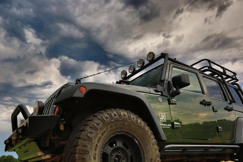

Crop of above image to better show where wiring comes through fender ...

At the light bar ...
At the interface between the cowel and the overhead rack ...
Again, the bracket that you see to the right of the cowel is for mounting a TJ mirror to my Jeep when running doors off. I leave the bracket in place to protect the nutserts holding it from spinning out (had a problem with that in the past).
