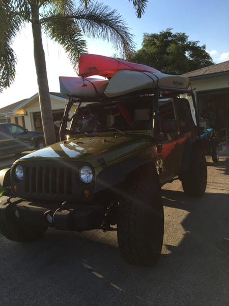

I just installed the Smittybilt SRC overhead rack, works great, I'm carrying 3 kayaks up top with no issues, length ranging from 12'-15', installation did require a bit of force, some of the holes were a bear to line up, but all in all I'm very happy with it.
