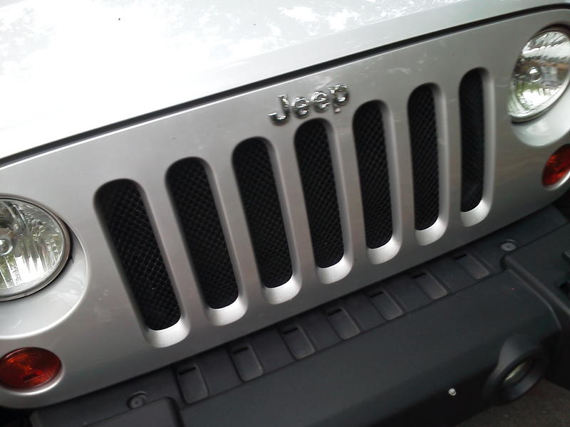

Originally Posted by DKJeep17
Before you spend so much money- search for "Grill Mod" in the Writeups. It takes, oh about 1-2 hours and costs about $21.00. Go to Home Depot (or Lowes, your choice ) get 4 pieces of the 3'x6" Gutter Guard Mesh. Go to electrical, and get the 1"x1" ziptie blocks and then some small zipties (and you may want some strong glue as well)
You will cut the pieces for the back of the grill, tie them up together and done!
The picture attached is what it looks like on the back of the grill. PM for any questions!
I agree very cheap mod and It works great. I did the same thing except I used the plastic black gutter guard on a roll. Did not have to paint.

Here is how mine turned out.
