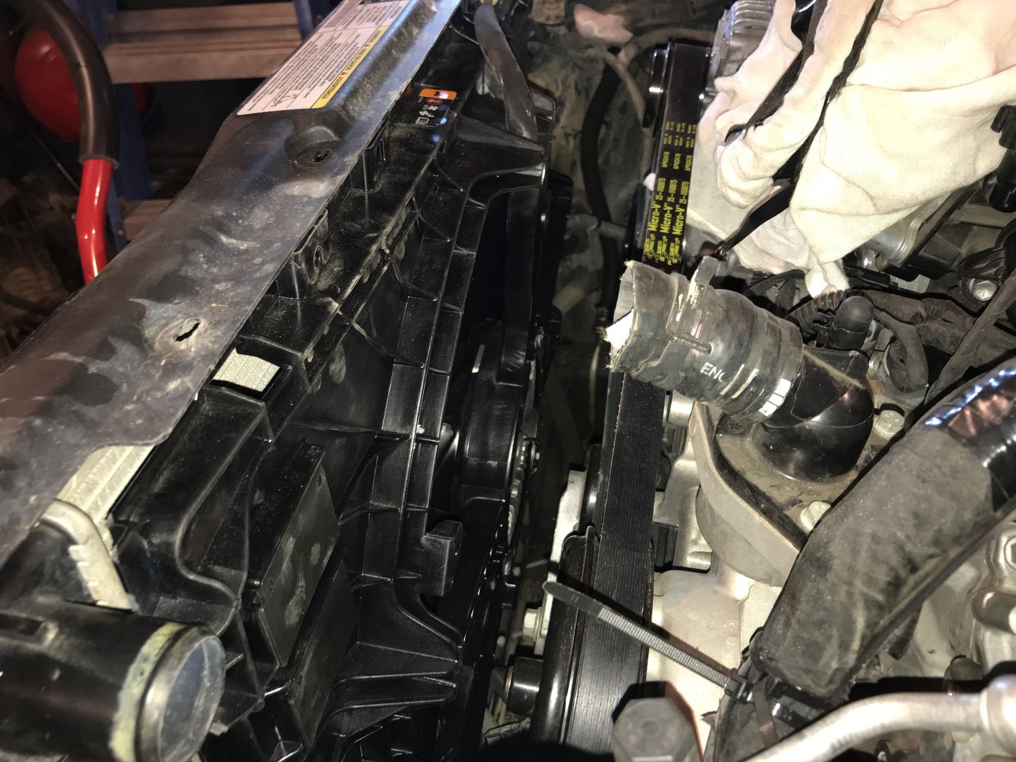

Just to show how that SS Fan fits please see attached. Almost like Chev made the Camaro fan for the Jeep. Just need some seal strip then it goes in. Had to cut some tabs off though. Pretty scary cutting into a $700 fan.

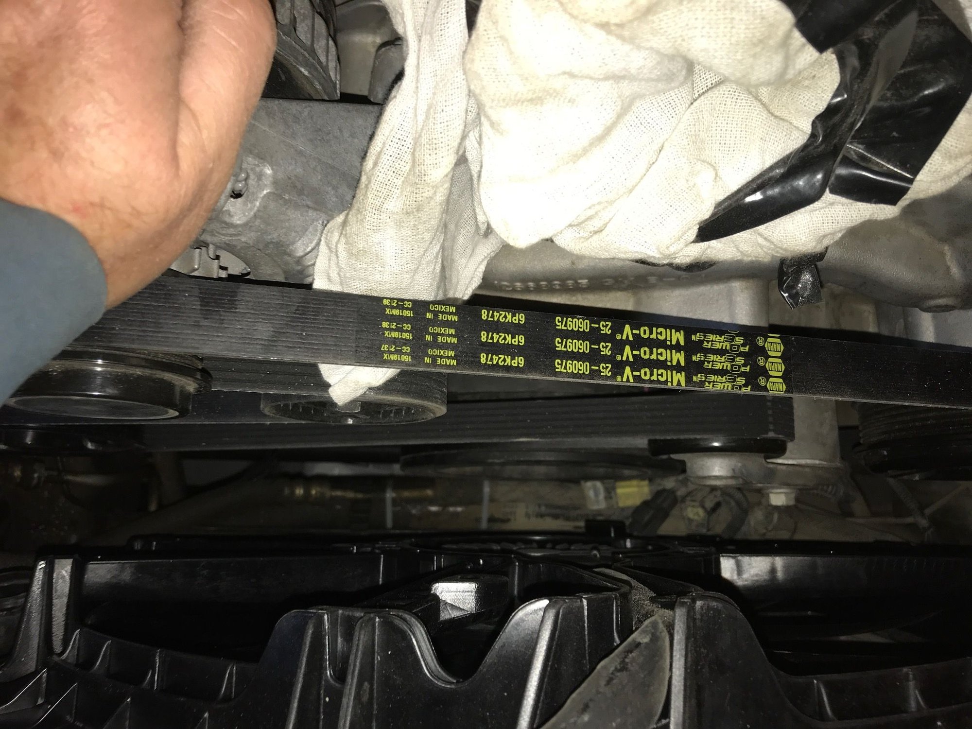

Clearance from fan to Engine pulleys. Love the Gen V conversion as we use all Chev accessories and mounts with JK steering pump.
