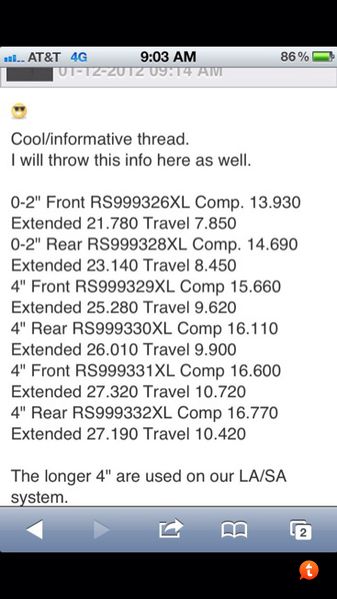

Old Sep 14, 2014 | 11:32 AM
D_engel's Avatar
Posts: 2,539
From: Tempe AZ
Measure your compressed and extended lengths and shove the longest shock you can in there
