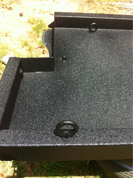

Raptor lined my tuffy deck today - that is some cool stuff - next is my hunting buggy that thing is about to be completely Raptor Lined!!!!
