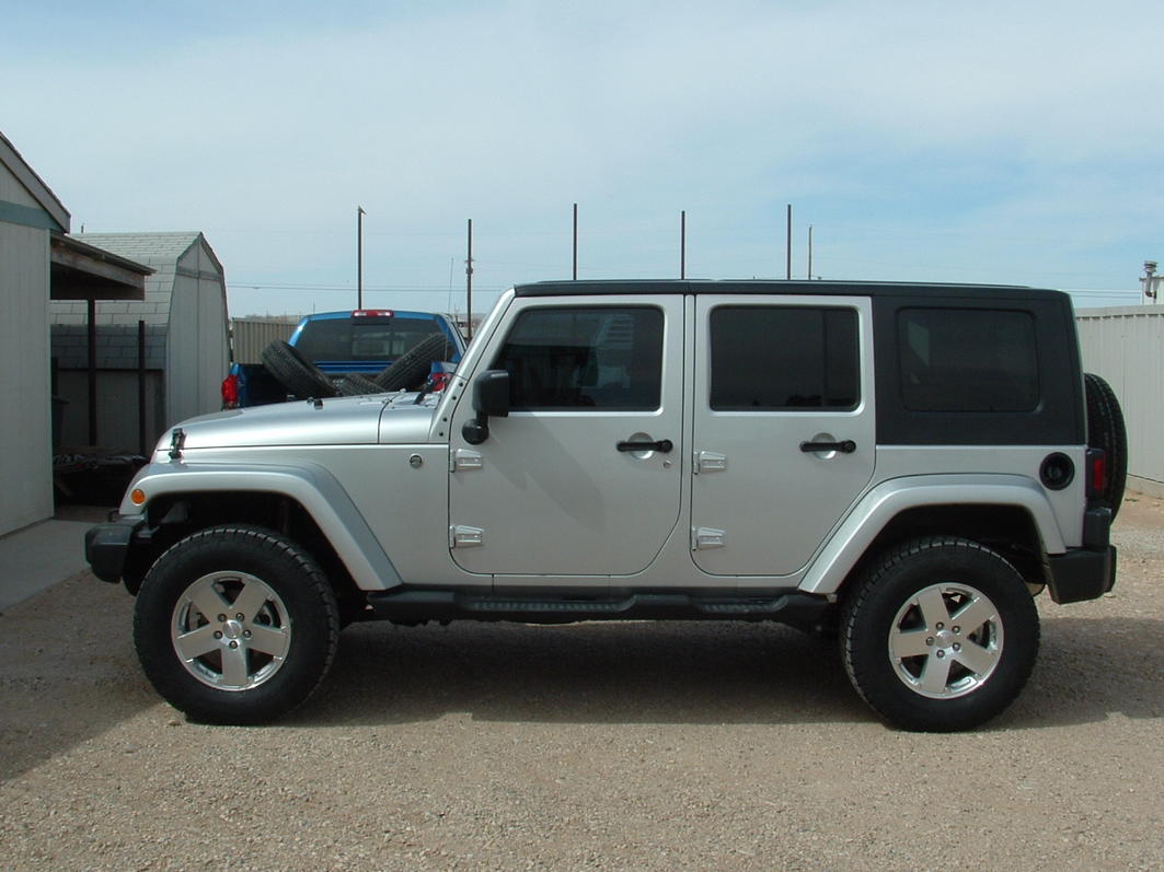

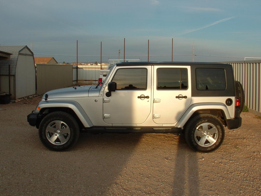

I installed this kit last weekend with their 2.2 shocks. Quite happy with it for our purpose, it is the wifey's DD. The ride is comparable to stock, yet less mushy, less body roll and brake dive. The slightly harsher ride on my rig comes from the 10 ply tires is installed, still toying with air pressure on the Nittos. Here is before and after, the tires are 275/70R18 Terra grapplers, which are 33.4x11.25x18.

Here you go. With the stock size P225/75/17.
