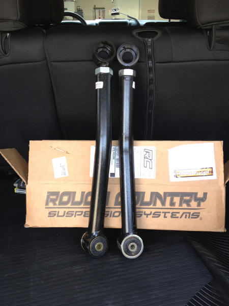

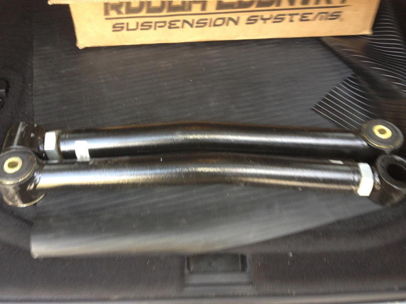

I don't know why people talk crap about RC products. Everything I have ordered from them has been very beefy and well made. Here are my LCAs. My track bar was damaged in transit so they have to send another.

Will be installed tomorrow along with my new wheels.
