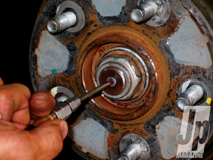

here is the JP article:
jpmagazine.com/techarticles/drivetrain/154_1001_rcv_front_axle_shaft_kit/index.html
here is a pic where the grease fitting is, just like Alaska said, u need the needle adapter for the grease gun. as for your boot, who knows, they have u break it they replace it policy, so see what they say, maybe u just another boot, they are only $5
