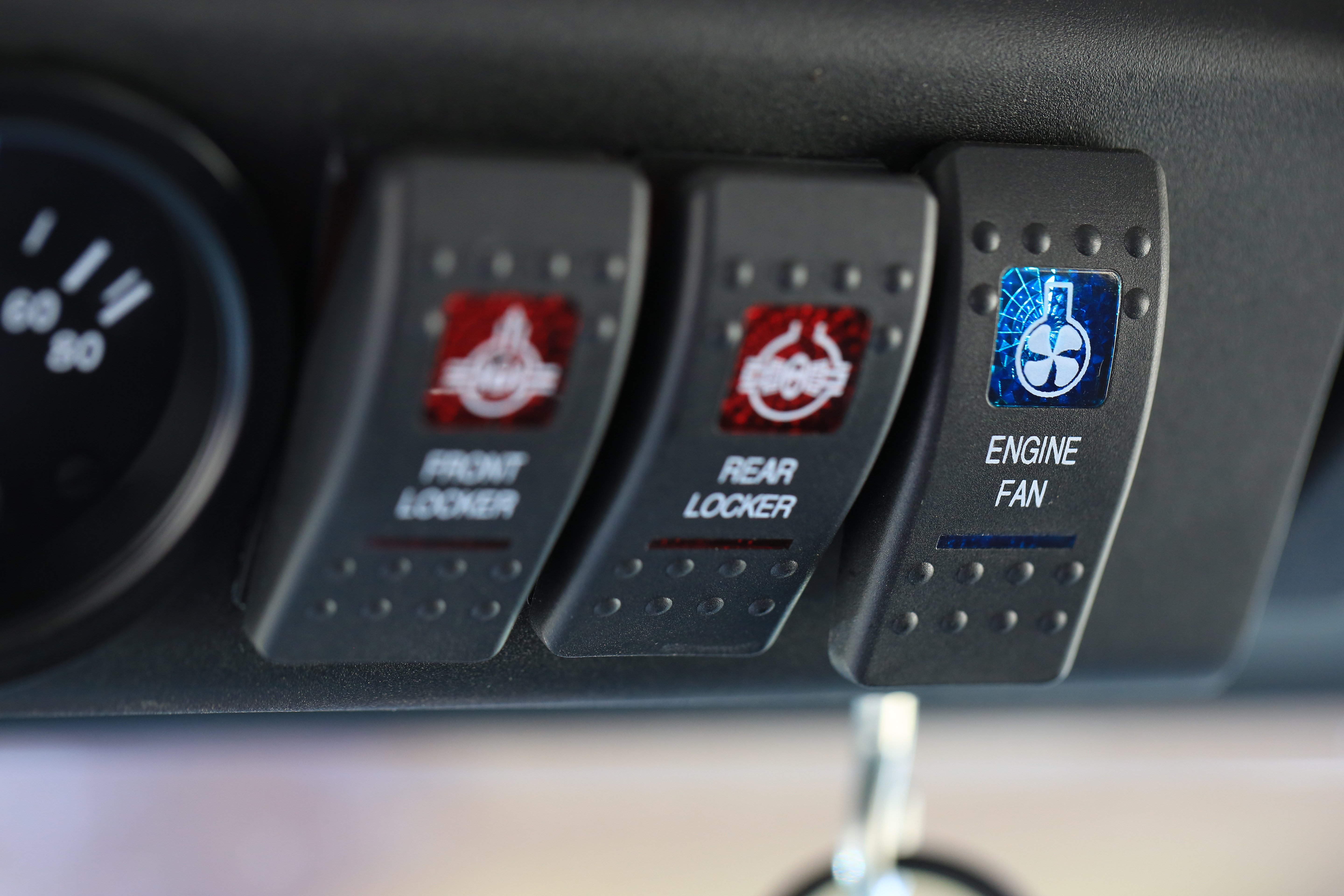

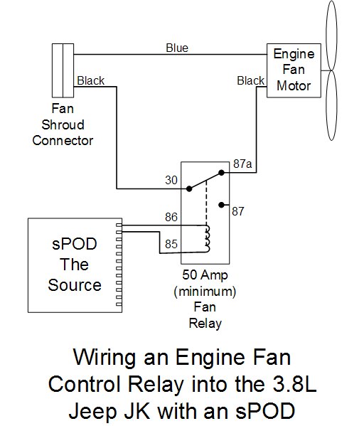

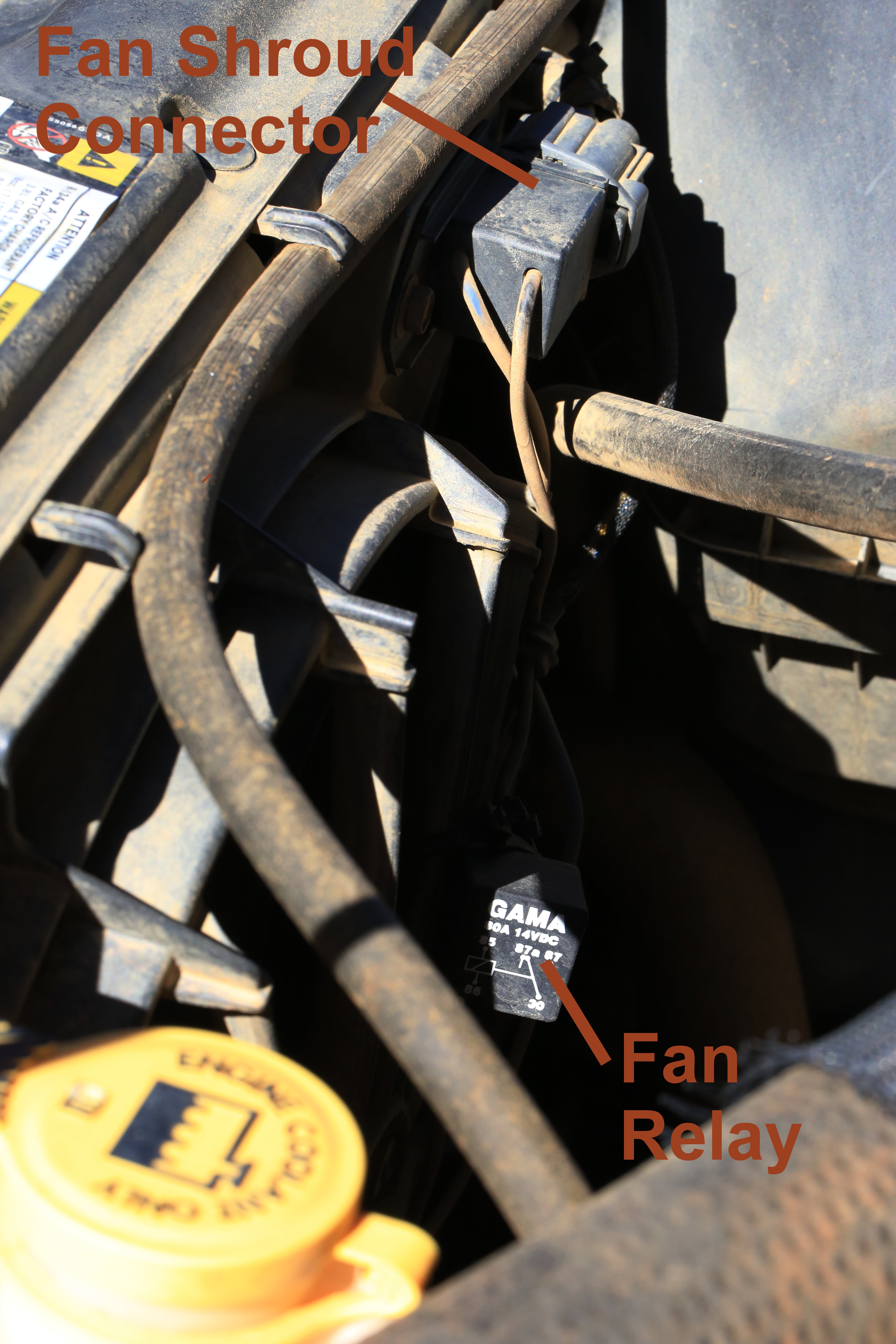

I have an sPOD and one of the problems with it is that it's designed to turn things that are normally off on, not to turn things that are normally on off. That may sound like a fine distinction, but I wanted to wire the sPOD to control my engine fan on my 3.8. Here's how I did it ...
Note that on a 3.8 there are only two wires to the radiator fan. On a 3.6 there are three. Ignore the extra wire (I believe it is white). A friend with a 2012 said that worked fine on his 3.6. Also note that there is a lot more power going to the engine fan than you may realize. A small horn relay will not work--besides, it needs to be a five pin relay, able to pass a signal through when powered off (which is why the sPOD doesn't do the job directly). I recommend this relay ...
http://www.amazon.com/Power-Relay-Si.../dp/B001PNMBE4
I attached the new relay to the fan shroud with some Zip-ties. I wrapped the connections with F-4 tape (Google it). Bear in mind that the relay I recommend comes with a couple extra heavy duty terminal lugs designed for its oversized pins.

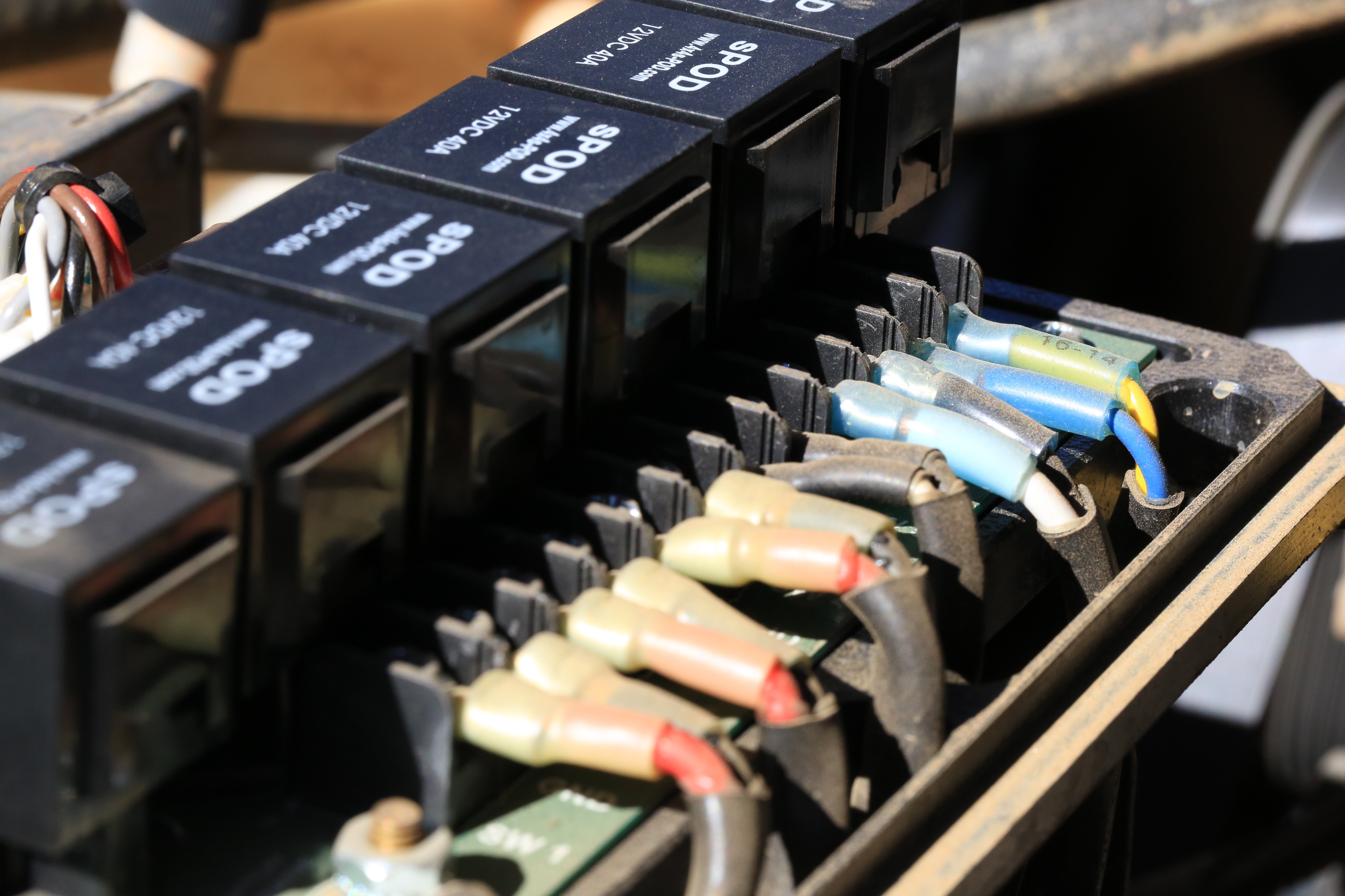

I wired the relay control wires to the sPOD. Bear in mind that the way this works is what you want: I can override the Jeep's decision to turn on the fan motor. I cannot force the fan on, but I can force it off.
What that means at the sPOD controller is that when the switch is powered on (as shown in this image), the fan cannot run. Go very long like that and the Jeep will let you know because the engine can easily overheat. If you don't have an sPOD, then you can wire a switch to serve the same function: Wire it so that the switch, when activated, powers the coil of the new 80 amp relay. That will remove power from the fan no matter what the Jeep tries to do. When the switch is in the other position, that will allow the Jeep to decide whether or not to run the fan. Again: You do NOT want to wire it so that you have to remember to turn the fan off and on as you're driving the Jeep. this is just an override to force it off for a brief time while fording a stream.

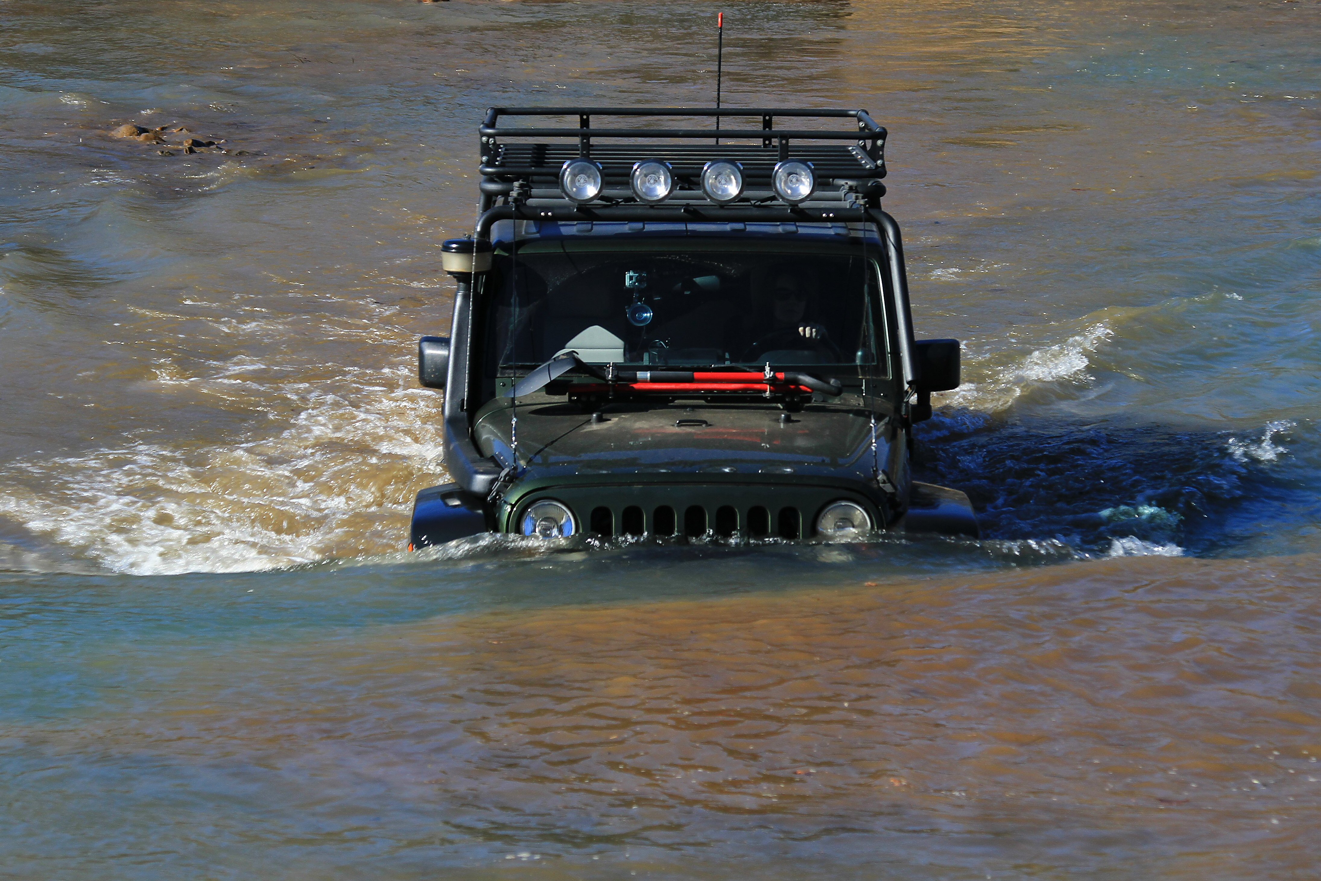

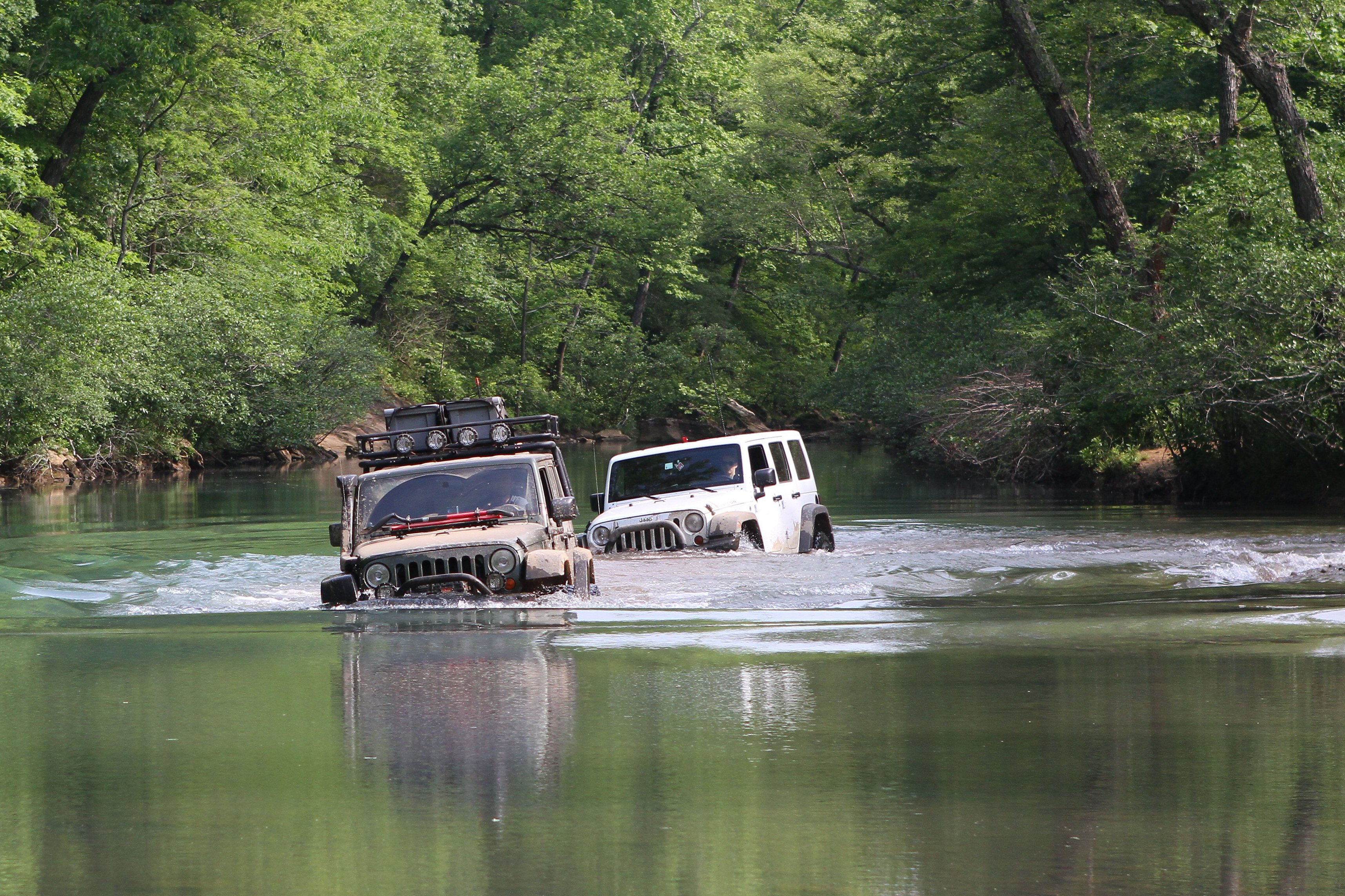

And, because pictures of river fording are fun ...
And this is not how you ford a creek (or the Buffalo River, in this case). The friend driving my Jeep is a highly experienced overlander and knows that and was just screwing with me.
