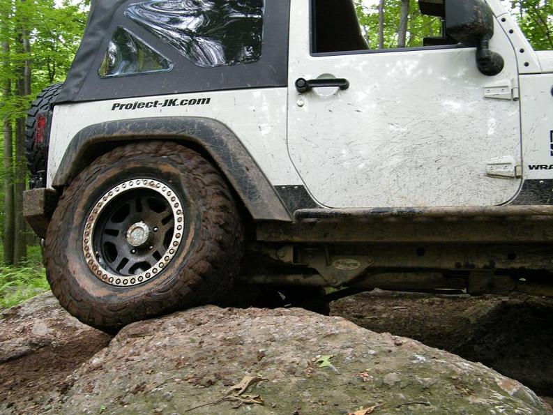

Here's mine way back when i first got it....
front connected on the same type of incline (sort of):
notice how the rear is stuffed?
same spot, but front dis-connected:
the front is doing most of the flexing

Yes....Its because your front sway bar is disco. The front axle is doing all the work (flex) since its disco and less resistance. The rear sway is doing its job and causing the no stoff effect.

the front shouldnt have anything to do with rear stuff. the TF springs just dont stuff like others do, but they should stuff more than that.
