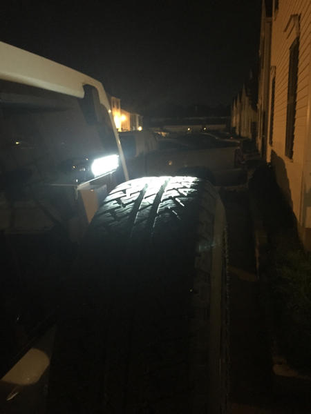

Very clean, simple, OEMish and damn bright ! Coupled w/ a quality PNP CREE style Tower replacing the yellowish backup stockers. Lookout <img src="https://www.jk-forum.com/forums/attachment.php?attachmentid=606551"/> <img src="https://www.jk-forum.com/forums/attachment.php?attachmentid=606552"/>
How far away do the lights sit from the curve on your bumper. I'm thinking about doing this, but cutting holes in places that holes aren't already scares me a bit.
Old Apr 15, 2015 | 06:50 PM
  #23
Eddie Man's Avatar
Joined: May 2014
Posts: 80
From: Clarkston, MI
The flange of the LED assembly sits about a 1/2" from the curve and 1/2" from the top.
The actually bumper cut is roughly 1" from curve and top.
This mod actually was fairly simple w a Dremel and a fresh cut wheel.
There is a void in that specific location that misses the steel cross member of the bumper.
The fastening part was a little tricky though.

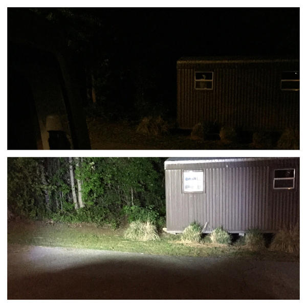

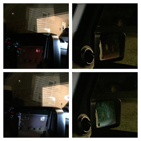

Finally got mine all wired up
