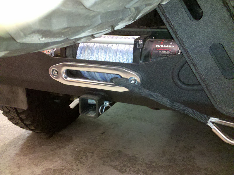

You just sold me John. I've been waiting for that open top winch picture for months. I'll get some $$ together and talk to the missus. Is your price of 1200 and change shipped anywhere in the us? I've got a warehouse in Maine.
