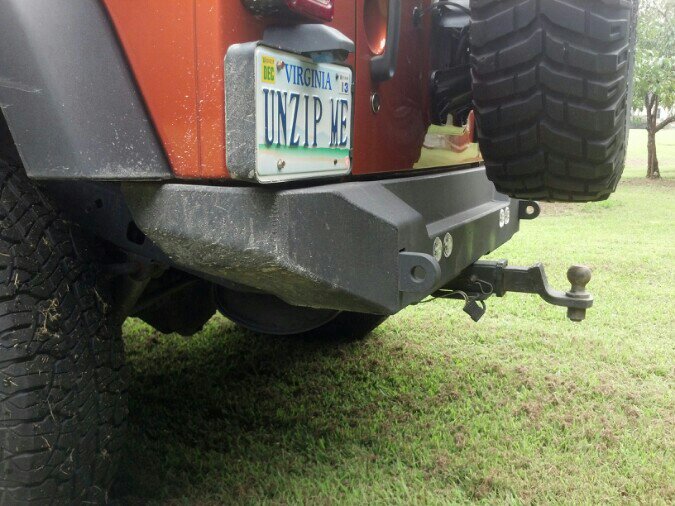

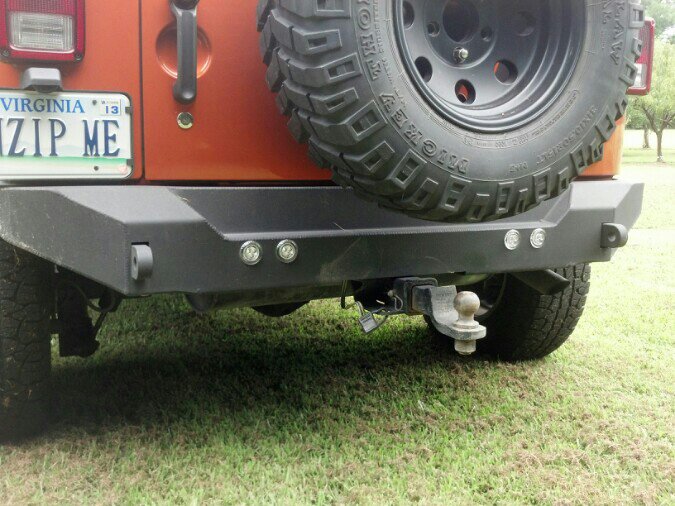

karls's Avatar
Posts: 2,873
From: 36* N
It's not flush but pretty close, GenRight rear.
ID:	533126Click image for larger version
