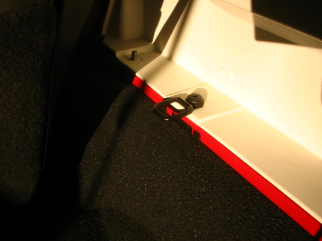

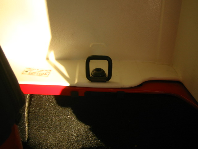

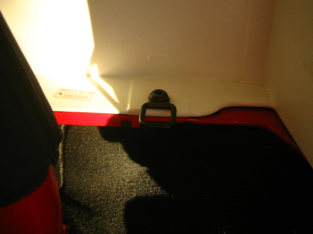

I apologize now if someone already did this one, but anyway I bought extra cargo tie down brackets/hinges from Chrysler/Jeep part #55361485AA. I attached them to the existing hard top hold down bolts. It was like they were made for each other and super secure. They were about $3.10 a piece. With this part number you may be able to find them even cheaper.

Be prepared to wait a day. None of the dealers had them in stock. Only took a day though.

Is it one per part number, or do they come in pairs?

One per part number. I originally was going to attach them to my gear box to keep it from sliding. Still going to do it with something to secure it to now.
