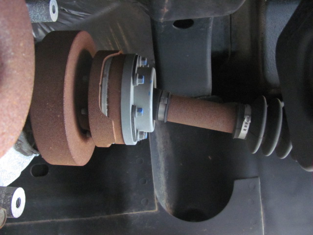

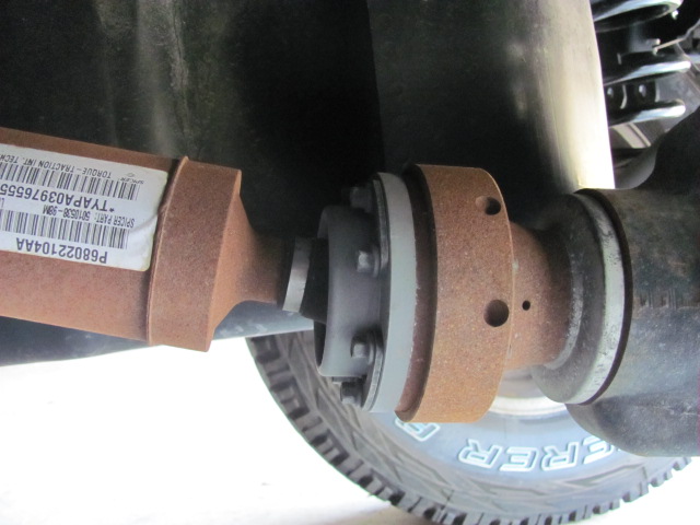

Current pinion angle:
Current t-case angle:
Looks to me like the rear DS pinion angle is OK (not perfect, but OK) while the t-case angle is about at its limit. Jeep is sitting flat in the garage.

looking at your pics, your DS angle is steep enough to put your CV boots in a constant state of pinch. as it, they will fail sooner than later. regarding your understanding of things, i should inform you that they are incorrect. ANYTIME you install a rear u-joint style double cardan drive shaft you MUST set your pinion angle to be in line with your DS and adjustable rear upper control arms is the only way to do that. as far as flange vs. yokes go, flanges work but they will reduce the length of your shaft and therefore put more of an angle at the double cardan. not as big of a deal on a rear shaft but, a yoke will allow you to have less of an angle and therefore minimize any chance of vibrations. i definitely wouldn't install a flange setup up front if i could help it.
