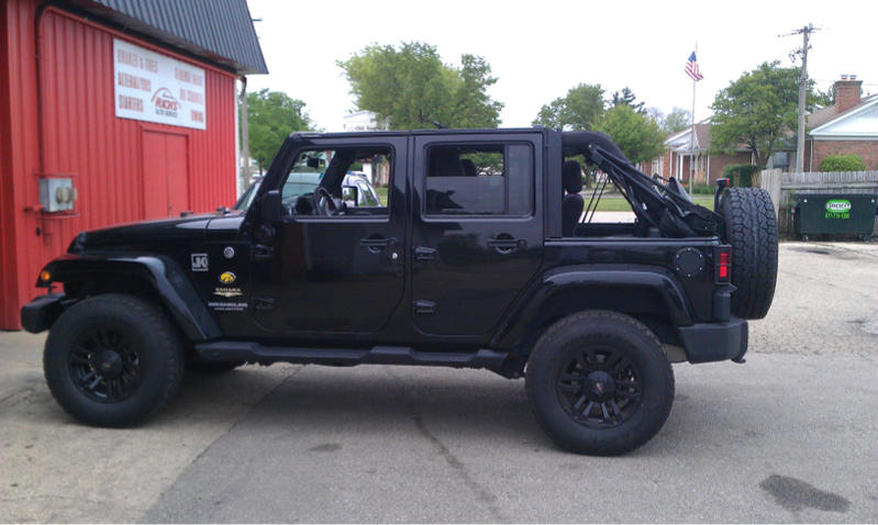

When I installed the Daystar 1.75 lift last spring I did not put the rear isolator back in and have not had any problems.
<img src="https://www.jk-forum.com/forums/attachment.php?attachmentid=414146"/>
I like the look and the black wheels!
