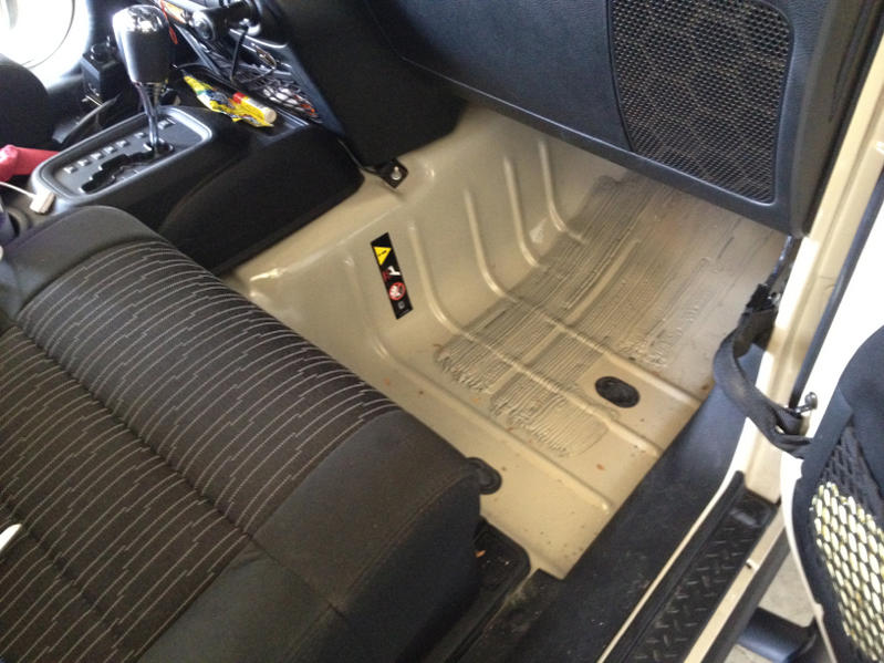

I just pulled my front carpet the other day. It was pretty simple. My concern is will it be ok I'd I don't bed line it. I want to pull my back carpet soon.
Sure, but not forever; it's just painted metal. The paint prevents rust, and the carpet absorbs moisture and protects the paint. Abraisions from feet, dirt, stones and other materials can scratch the paint (not unlike sandpaper) and the exposed bare metal can start to rust. So, you can either paint it regularly, or bedline it once.
Bedlining it will ensure it's protected from abraision and make water in the jeep a non-issue.
