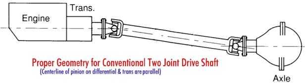

This would be a good opportunity to correct your rear pinion angle if you haven't already after your lift. Getting an adjustable lower CA would allow you to do that.
Old Apr 11, 2016 | 02:48 AM
kjeeper10's Avatar
Vet Army
Posts: 3,440
From: CT
Running only lower arms set longer rotates the pinion down. In order to run a longer fixed lower control arm he will need adjustable uppers to set pinion. The only other option is to run a adjustable lower set to stock. Later add adjustable uppers to set wheelbase and pinion.
Old Apr 11, 2016 | 03:02 AM
14Sport's Avatar
Joined: Nov 2013
Posts: 3,703
Likes: 8
From: The Dirty South
Doesn't the pinion rotate up when you lift?
Nevermind, I was thinking of it backwards. The lower CA would have to be shorter than OEM.
Old Apr 11, 2016 | 03:10 AM
jeepfan30's Avatar
Joined: Sep 2014
Posts: 111
From: DuPont, WA
2.5 inches of lift on a JKU doesn't throw the rear pinion out of whack. I have a 3" lift and my rear pinion angle is fine. The only reason I would get the JKS rear lower links is because they are beefy as hell, and have a stock like bushing for smooth ride. I never plan to go over 3" and if I did need to adjust my rear pinion angle I'd get adjustable rear uppers.
Also, the JKS J-Links are same length as factory lower arms, just a beefier alternative to the stock rear lowers.

You would want a arm that is slightly longer to push the axle back to the center of the wheel well. When you lift with factory arms the axles move towards the center of the jeep causing a slight loss of wheelbase. However adding longer lower links and leaving the factory uppers you will rotate the rear pinion down.
