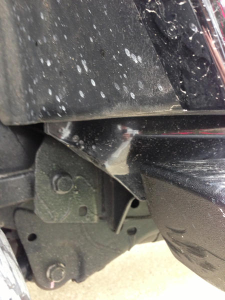

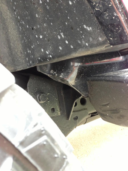

Cut with angle grinder. Filled with bondo and repainted

Be sure to cut in front of both spot welds so it all stays together also. There's a good video on you tube

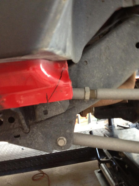

Originally Posted by onecrazyfuq
Can someone explain to me why one would cut their pinch seam
Stole this pic from another thread here. When larger than stock tires get stuffed up into the wheel well, they can come into contact with the sharp corner piece - possibly shredding the tire. This pic shows where he has marked to make his cut.

Whether or not you need to do this depends on the tire size, lift height, bumpstop height, etc.
