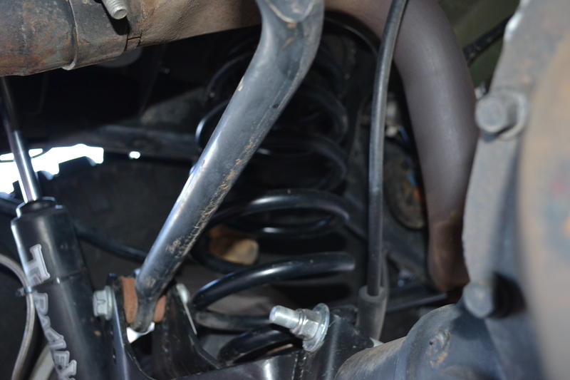

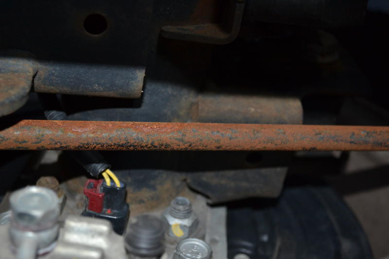

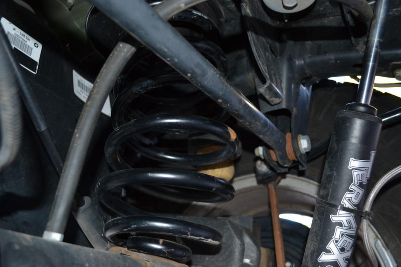

so after the jeep has been in the wifes care for awhile now i got home and started going over my baby head to toe. to my dismay my rear springs are bending out a good bit and my swaybars are surface rusting like a mutha-trucka. heres a few quick snapshots, tell me what you guys think and how i can fix the issue. only wieght on the rear is a smittybuilt xrc bumper and spare 35" tire. I have the rear upper flex arms and front lowers currently installed as well.

Wedges, bolt on perch, weld on perch

Easy fix - wedges
More permanent fix - JKS bolt-on perch, or Teraflex weld-on perch. I'm going with a Tera weld-on perch just because I worry a lot about U-bolts sliding around or something.
Rotating the axle would help some, but be careful if you rotate it too much to fix the coil bowing, it might hurt the pinion angle on your driveshaft.

Cheapest option are the polyurethane wedges for about $35. I would recco spring retainers with this though. The next option would be the bolt-on's (about $125). I'm not too keen on the weld-on's unless you know for sure that you won't ever change your setup (lift height). I myself went with the wedges with spring retainers. Works great and no problems.

Shorten your rear uppers a little, just make sure you don't drop you pinion too low. Pull the links out and hit them with some Hammerite paint.
Mine are doing the same thing from all this damn road salt. Where can I get some of this Hammerite paint? I assume I'll need to mask off the bushings and zerks, correct?

We offer simple poly coil spring correction wedges that will help with your issue and they will also firm up the ride due to the lost effective spring rate from the coil bowing!
Just food for thought and they are only $24.99 per pair.
I've seen it at Lowes/Home Depot/Checker. Your correct on masking those off is the correct way, I'm not going to on mine.
