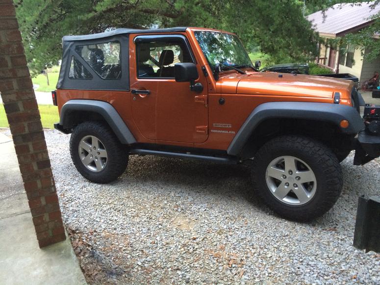

Taller factory coils may be the ticket for you. I have 17s in front along with a 1'' spacer (replaced 14s)..with a relatively lightweight winch/aftermarket bumper combo I 1 1/2'' Out back I went from 54s to 59s and gained about 1''. Sits about perfectly level.
