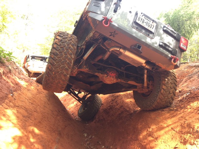

Well, you're at a fork in the road....lol. When I came to that fork I chose to remove the stock muffler, and move the rear sway bar back an inch with by drilling new holes in the frame and using some self threading bolts. I now run a cheap $35 thrush welded muffler which I actually like just fine, and paid $40 to have a muffler shop mount it up and bend a pipe to mount where the factory was bolted up.....just in case I didn't like it. I don't recall any odd feeling prior to that, but I hated hearing my sway bar links leaning so far forward and close to rear upper arms. I know a couple people that just run without rear sway bars, but I wasn't thrilled with that option myself. I also run a skinny series rear bumper, so not having that big factory muffler hanging down was really nice benefit as well.
