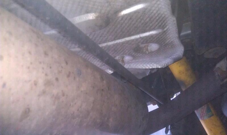

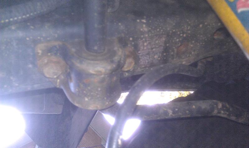

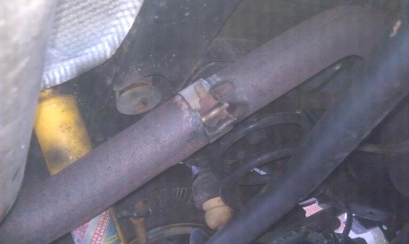

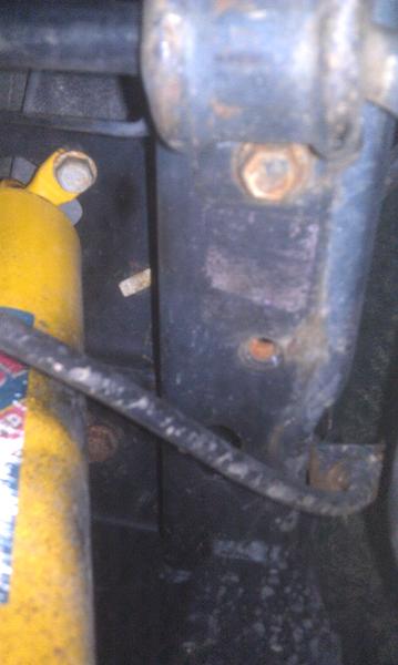

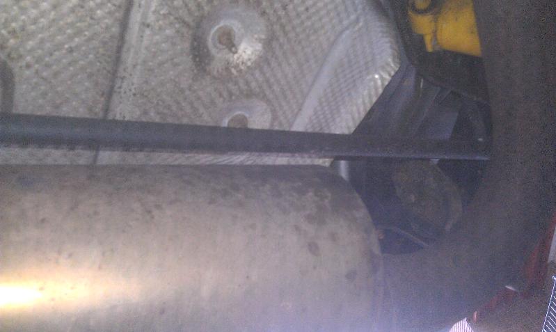

Ok here's a few pics to show where I moved the swaybar back on the frame, and the clearance from the swaybar on the muffler, and the clamp u need to loosen to move the muffler a bit..
The swaybar mount was moved back, and the front hole in the bracket was put into the rear hole In the frame, then drill and tap to same thread/pitch as stock bolt, and install bolt. Done.
