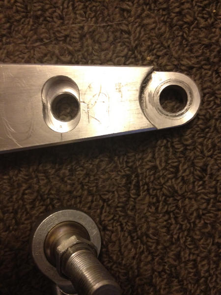

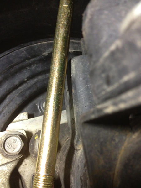

Has anyone thought out drilling upwards on the rear bracket
With extended end links barely clears

So I'm trying out this as well I know the rear sway will be tighter but will help me clear the rearend

So far it clears and fits. I will be doing a test drive soon to see how it handles the relocated hole
Additional things needed so far
Had to additionally drill 1 inch above lower end link to gain clearance even for a 14 inch rod
Had to put on wheel spacers to clear end from away from inner tire. That's with a current 4.5 backspacing rim total of 3.0 back spacing required.
Cannot run end links on inside due to passenger side will contact frame using the currie rear antirock

Worked out great with the mod
