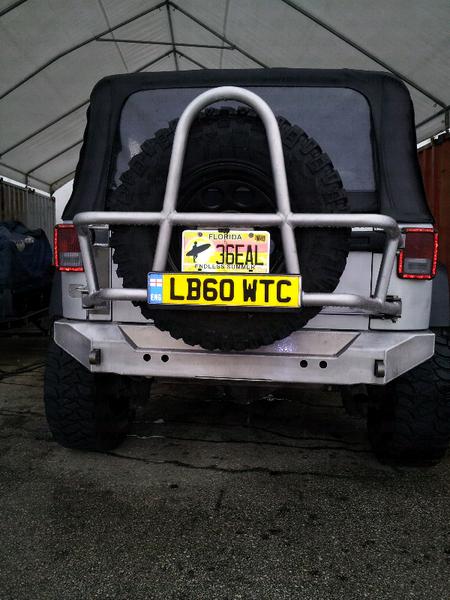

The stock tire carrier while hold a 35 but im pretty sure you need an adapter,I did. Now i just use this.
Old Jun 7, 2012 | 01:26 PM
JE8154's Avatar
Posts: 2,256
From: Madison, New Jersey
no adapter needed. I'm running a 315/75r16 on the stock carrier no problem right now. Tire Carrier is on the list after re-gear.
