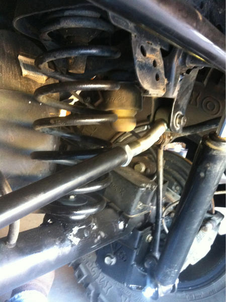

So for the first trip wheeling that I had passengers in the back seat of my 2 door with 4" teraflex lift. I had issues with the rear trakbar. There was a loud pop so I get out to discover that my rear trakbar (stock) is hitting my passenger side coil spring and my new arb diff cover. I also notice that the teraflex bump stop located on the axle is hitting my trakbar mounting bolt. I have a few questions about what to do.
1. Will the teraflex monster rear trakbar route so that it doesn't contact anything?
2. Do I need to cut off my lower spring perch and bump stop and reweld them so that my coils are straighter and the bump stop is more level.
3. Do do I also need a trakbar relocation bracket?
Here are some picture of my current set up.
I believe that is a trakbar drop bracket. See how close it is to the coil.

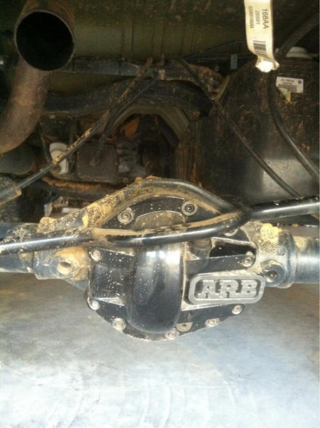

The cover is hitting right above the Allen bolt above the arb engraving.

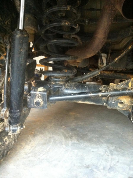

Drivers side

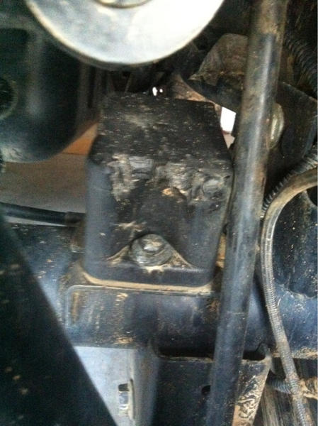

Where my lower bump stop is hitting the trakbar mounting bolt.

Looks like you need any adjustable trackbar. ( I prefer rubicon express) I would also put a LOWER trackbar bracket mount on and ditch the upper mount you have. The upper should be in the factory position at the frame. This will allow your trackbar to be almost above your diff cover as it crosses behind it. That is how I have mine set up and I have at least 2 inches of clearance when my trackbar comes down. Never comes close to hitting the diff cover.

Did you purchase your Jeep with the lift already installed or did you install it afterwards? Looking at the rear track bar bracket that doesn't resemble the TF bracket. Maybe that is the reason for your issue. The bracket may not have correctly centered your axle.
Either, getting the correct relo bracket or an adjustable track bar will center your axle and thus prevent the links contacting your Bump stops.
As for your springs, do you have adjustable control arms? With that much lift that could be the cause of your springs being that way. Having adjustable control arms can help dial in/adjust your suspension. Another alternative would be to get spring wedges, but Having adj control arms will help address the springs bending as well as help align your DS, pinion and fix any DS vibration if your are experiencing any...

That picture with the trac bar relocation looks wrong. There is no clearance at all. All of the ones I have seen are on the axle. I would either get an axle bracket or an adjustable trac bar.

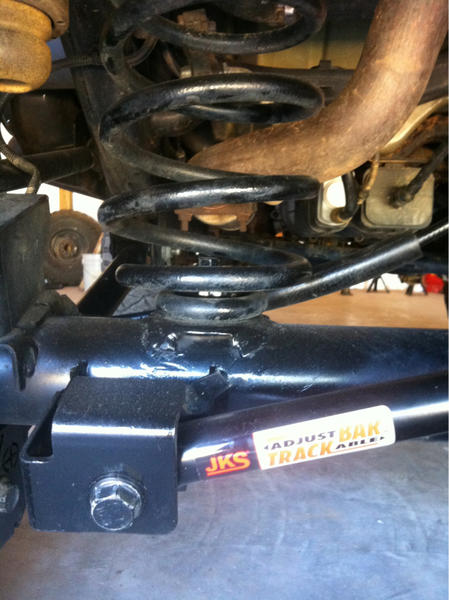

Well the Jks track bar still hit my coil springs. I removed the fame side drop bracket. I also cut off my lower spring perches and moved them to the top of the axle. Now my coils are not bowed and my track bar does not hit. I may still get an axle side bracket though.
Going to take it out in the morning and see how it will flex out. Hopefully I have this problem whipped.

You have a early early TeraFlex 4" kit, they came with a frame side drop bracket. Send me a PM with your name/address and I will send you the current version.
