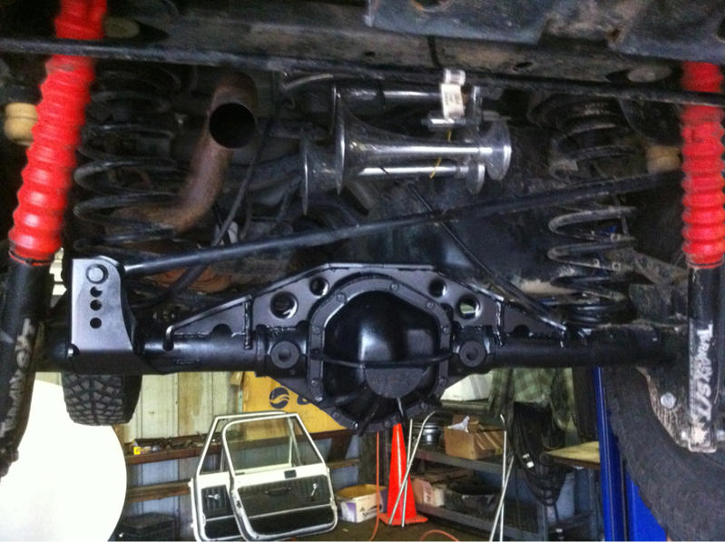

Here's a pic of my new Artec truss and track bar bracket.. Good stuff.. Bomb proof..

Originally Posted by Justinn407
<img src="https://www.jk-forum.com/forums/attachment.php?attachmentid=429416"/>
Wow, I really like that. I might end up going that route, looks sturdy!
