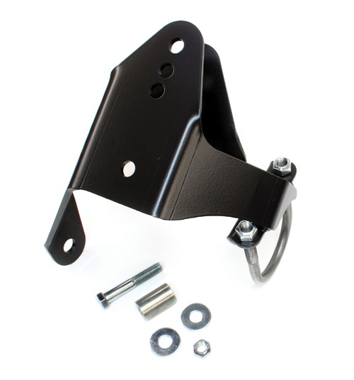

Part of the TF bracket bolts to your rear lower control arm mount and the axle side of it has a big u-bolt to tighten it to the axle. A very strong design imo. You could also add some welds to it if you wanted, but they're not needed imo. I've been running it with my jks rear adj trackbar, no issues.
Old Jun 26, 2010 | 10:15 AM
mkjeep's Avatar
Posts: 15,665
From: Hammond Louisiana
a pic.......

not the best pic but i had it on file
the tera one is super legit for bolt on
