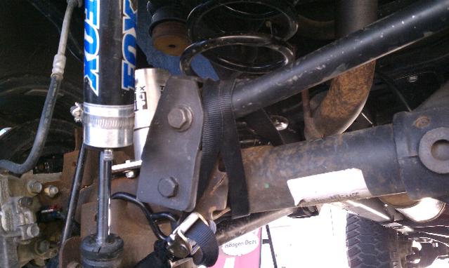

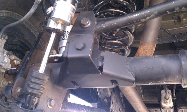

I have the jks reinforced mount on the axle side, I also at the same time welded on my cheap trackbar relocation mount to the axle side. Works great and very strong. I'll put a pic later. I did some Google searches but can't remember who made the mount. I have an adjustable bar and a 4 inch lift, with a lot of weight so its probably less, I recommend the teraflex rear bar because it will adjust shorter then most bars, I had to cut my rock crawler. I like the set up because the bar is more horizontal. That being said most people run just an adjustable trackbar in the rear that I see. Hope that helps.

The first is the relocation mount on the stock broken mount, the second is the whole setup I installed.
what bracket is that?
The big one around the axle is the jks one. The one welded and fabricated to it I can't remember. I thought it was from a fabtech lift kit.
