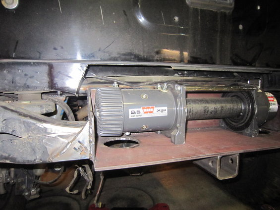

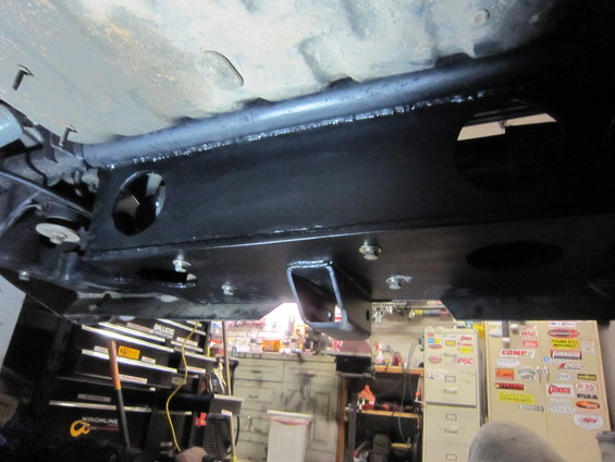

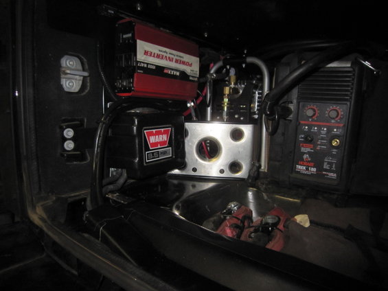

I've run a rear winch on my last three rigs and have found with just a bit of shielding from the elements they last just fine. On my JK I had to give up the small jack storage area and I cut out the existing crossmember. I then built a winch plate that replaced what I cut out. It's protected from the elements, pretty secure and there when I need it.
Just throwing out another option for a rear mounted winch.
and the hitch reciever is just for a trail vice, I don't tow with this.
