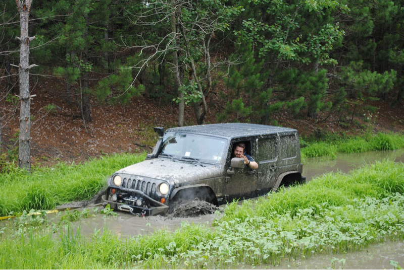

Just remember that when you come to need it you maybe up to you tub in mud/water already. Now you need to lumber about with heavy equipment up to your knees/hips in crap and hook this sucker up. With a good recovery kit, snatch block and a few straps, you can accomplish the most things!
With water already coming through the doors I wouldn't have wanted to exit the vehicle in this situation.
