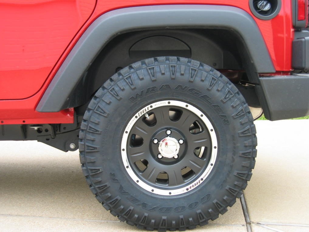

I have the Goodyear Duratracs in 285/75/16. They ride nice on the highway and are very quiet. I haven't had a chance to try them off road yet but iv'e heard they do very well for A/T. I have attached a pic.
