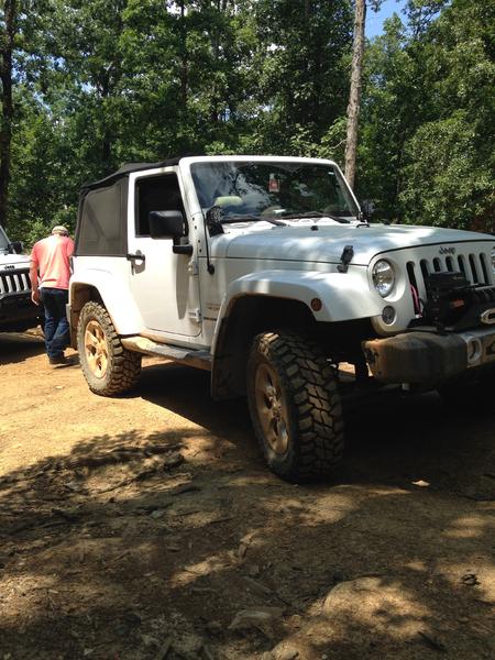

I vote for the Rancho 2" sport system. Comes with RS9000XL shocks. I'm clearing 33's with no issues, and mine actually see the rocks. If they are doing the discount right now, it's less than 400 bucks shipped. That means the lift is free, and you are paying for the shocks. I have no drive line issues, no binding, notta. Great flex, and you will have extra $$$$ to buy other cool things, like a winch plate or Terraflex HD hinge and tire carrier. The other fella that wheels with me most days has a 4 door with the AEV 2.5" lift, and it does nothing mine doesn't do for double the price. Bonus, I have adjustable shocks and his came with Blistens; which are good shocks just stiff and not adjustable.
