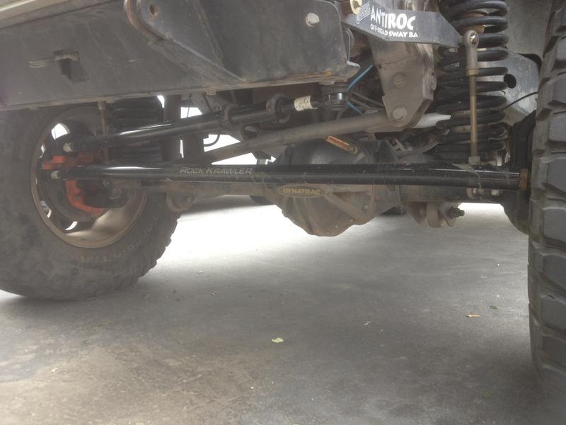

Just installed the RockKrawler TieRod this past Saturday then tried out out Sunday, seems to work great. I went with RK because it was less expensive the Currie. I run the Currie on my TJ and it is a great solid product.
As for TieRod Ends I did oder the Moog ends but they ended up not fitting and when I called RK to discuss they said get the Factory ones. I talked to a buddy with a shop that does a lot of custom off-road fab work, he told me that he has had a fair share of Moog parts not lasting. While we where talking a chevy truck came in on a tow truck and the Moog Pitman arm broke, and it was the 2nd Moog one on that truck in the last couple years.
On my install of the RK I ran into a problem, since it is aluminum you have to make sure that the threads on the TieRod Ends are clean and free from burs etc. 3 of the 4 that I bought and opened new out of the package from the dealer had problem with the threads. I didn't catch it until it was to late, and it trashed the aluminum threads on one end of the TieRod, the other end went in great. I was lucky to find a Tap and Die at McMaster Carr which was open on Saturday's and only an hour drive. So now another $150 into the Tap and Die and I was able to clean up all the threads and finish the install.
While I was at it I put the Reid Knuckles and the RK Drag Link in, (the other 2 TieRod Ends went on the Drag Link) Hopefully I will have time in this week to install the RK Track Bar as well.
Good Luck and you can't go wrong with either company.
