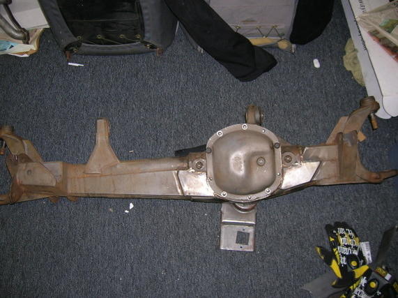

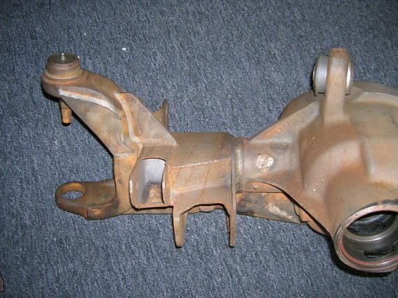

i was looking for the same information on building a bether front axle for cheap or less trouble than a dana 60. might not be as solid on some place but maby this will interest you.
( not my axle just found that on the internet yesterday. )
i dont think it would be to tough to do. i think i can make all the part out of ''woodcardbord'' and maby bring it to a machine shop. i dont have many tools at home. after that just need to weld everithing.
what do you think of that.
just need to paint that with por 15 and all done.
if i can find a front jk axle at junk yard i might do that.
