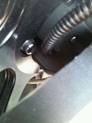

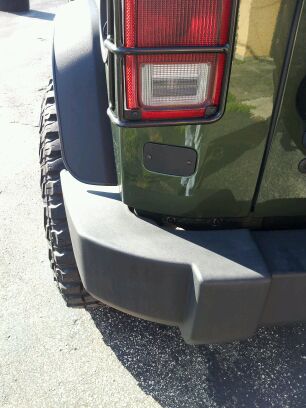

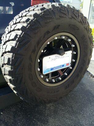

Did mine! Just cut and extend the light wires. I ran mine under the carpet, through the mesh to the gate, inside the gate then out to the plate holder. Followed the third brake light wires. Hard to see in pics but here you go.
<img src="https://www.jk-forum.com/forums/attachment.php?attachmentid=347844"/>
<img src="https://www.jk-forum.com/forums/attachment.php?attachmentid=347846"/>
<img src="https://www.jk-forum.com/forums/attachment.php?attachmentid=347847"/>
<img src="https://www.jk-forum.com/forums/attachment.php?attachmentid=347848"/>
How many wires? Its only two right? And can i get any wires or does it have to be special wires?
Is that the stock plate holder? And how did you hold it on therr
Old Jul 30, 2012 | 07:30 PM
KY JK's Avatar
Posts: 724
From: Louisville, KY
Two wires. Any electrical wire. Yes, that's the stock holder. A little nip and tuck and bolted it straight to the center cap.
