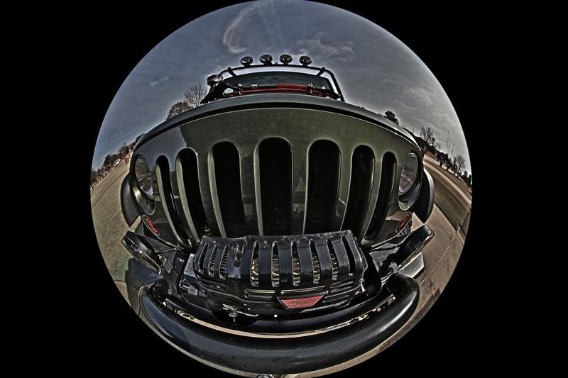

Warm day will make it easier. I did mine after it set out in the sun--was able to just pry the letters off with a screwdriver protected by a rag. Cleaned up residue with lacquer thinner. That was years ago, but I like it a lot better ...

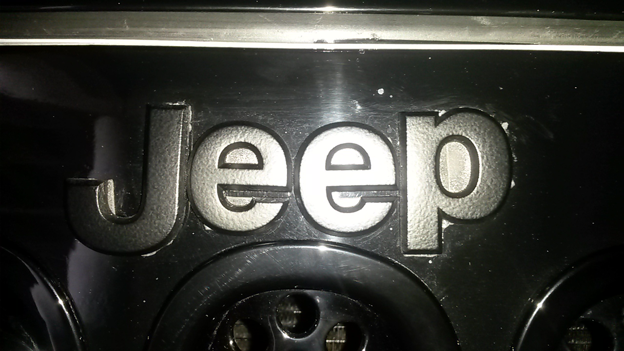

I need to remove mine. The guy who just painted my Jeep screwed it up.

That looks like they made a real mess of the emblem. Probably re-glued it on as opposed to a new one.

Fishing line and a blow dryer or heat gun!
works like a charm.
