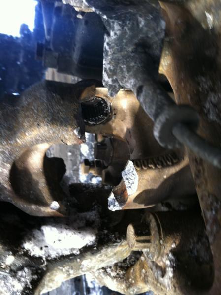

So the other day I trashed my driver's side front axle shaft. I've ordered a replacement axle shaft, and I am waiting for it to arrive.
Due to poor weather, my Jeep has sat (unmoved) outside since the incident. Just today I was able to get it into my garage, afterwords I notice a small leak on the driver's side. This is a small amount of diff fluid coming out of where that little plastic dust cover is.
Searching around the forum it would seem my axle seal is leaking. But, searching around the forum seems to indicate that most people just say "take it to the dealer" as the fix. I highly doubt my dealer is going to fix this, plus I am going to be in there replacing the axle shaft.
What is the procedure for replacing the seal? Where, exactly is the seal? It's not the plastic cap, right?
Oh, for the curious, here is a picture of the damaged axle shaft.
