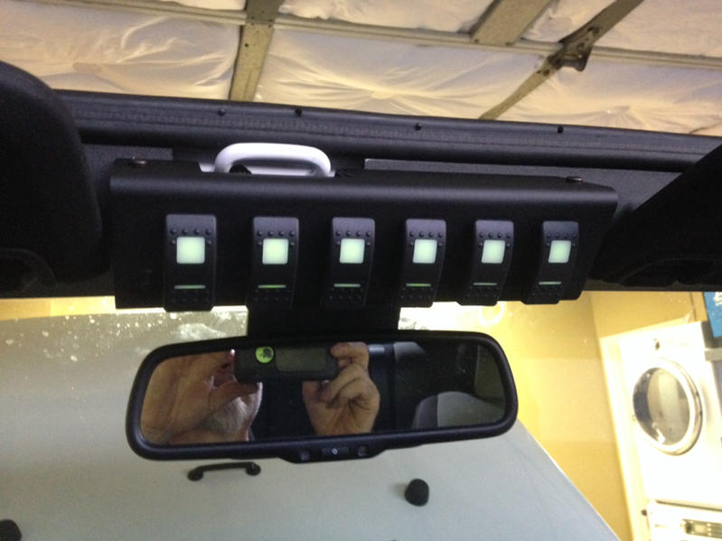

This is what my Spod came with.

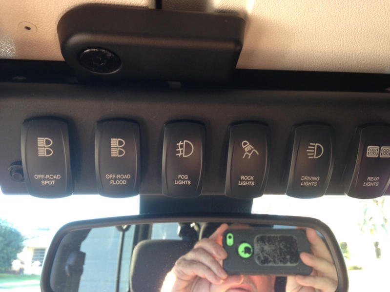

This is the Contura V's I switched to.

Sweet man I am looking for what set of lights i want to do first. I couldn't do 6 switches of just lights though, lol.
