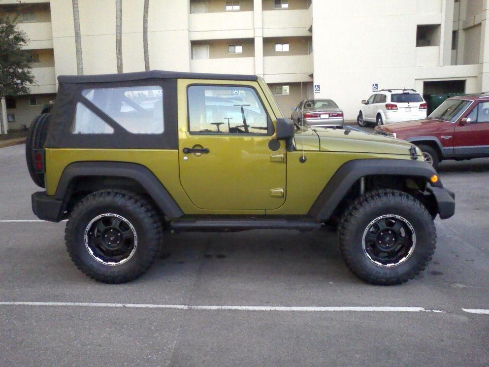

I put on the RC 2.5 coil lift w/ 2.2 shocks a little over a month ago. I know a lot people on the forum prefer other lifts, but there are also lots that like the RC, so whatever - It's my DD and I'm not off road a lot. Here's what I've added, and it seems the 2.5 spacer kit comes with this stuff ??? so why didn't RC just add these to the coil lift too......mm I may never know
So,
- Rear sway bar links, moved the factory rear to the front. I have elec disco sway bar, so I'm assuming the rear links are fine up front.
- Cheap extension for the rear brake lines (mending plates)
- Rear track bar bracket - haven't installed it yet, the axle seems pretty centered
And I added 34" tires, they seems to do ok with the 3.73, or 33's would be good too. I think 35's would be too big
