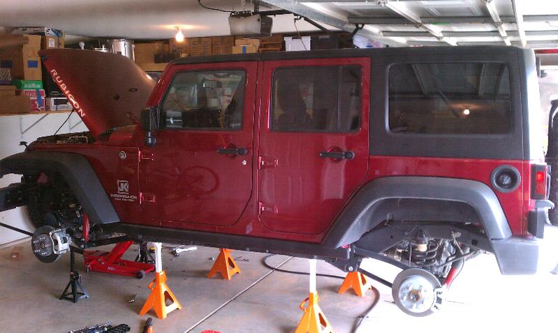

I've been working on my lift for 2 weeks now and I've had mine up on stands that long. I had to put them under the frame as I have to lower the axles to change the springs and shocks. The only problem I ran into was lifting it high enough. I used a 12" piece of 4x4 horizontally on my floor jack then under the middle of the frame to get it high enough. The suspension will fully droop so for changing the tires this may not be the best option as you have to lift the jeep pretty high to get the tires off the ground. And if ur lifted you'll have to go even higher. I'm wondering how I'm gonna get my new tires on with the lift. I'm pretty sure I'm gonna have to jack up the axles.
<img src="https://www.jk-forum.com/forums/attachment.php?attachmentid=297076"/>
<img src="https://www.jk-forum.com/forums/attachment.php?attachmentid=297077"/>
Best option is to bolt the stock wheels on the front or rear the opposite of what you are going to bolt the new on first. Just in case it slides of the jack stands. then jack it up by your pumpkin then bolt on new on pull the jack stands out. Then do the others.
That's a good idea. Yeah I've been working under it pretty regularly now but its still unnerving with it sitting in the stands. I'm constantly double checking them and using a jack for additional support where needed.
