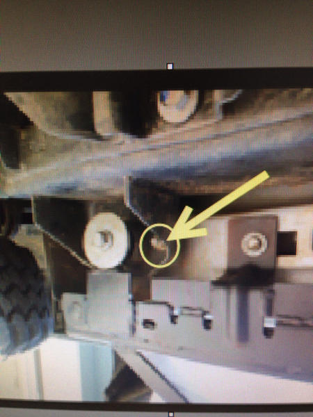

Im an idiot and I over tighten and snapped a bolt I have attached a pic does anyone have a clue as to how to replace it? Click image for larger version

Title should say rock rails but I'm sure u figured that out.

looks like a bolt that holds the body mount to the frame. I would start there.
Body Mount Crown 55366680AC | eBay

Originally Posted by jadmt
looks like a bolt that holds the body mount to the frame. I would start there. Body Mount Crown 55366680AC | eBay
Thank you I hope this works!

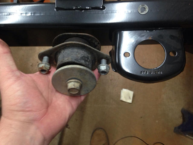

Body mount without body in way

Old Sep 24, 2014 | 03:29 PM

More pics with it removed
How does it come off? Just the 3 bolts?

The one body bolt and the body has to be lifted up about 2-3 inches to remove the broken mount. I suspect u will need to remove several body mount main bolts to get the body loose enough to lift that much clearance.
I have my jeep body fully removed for several upgrades and was easy to go outside and take pics of the area.
