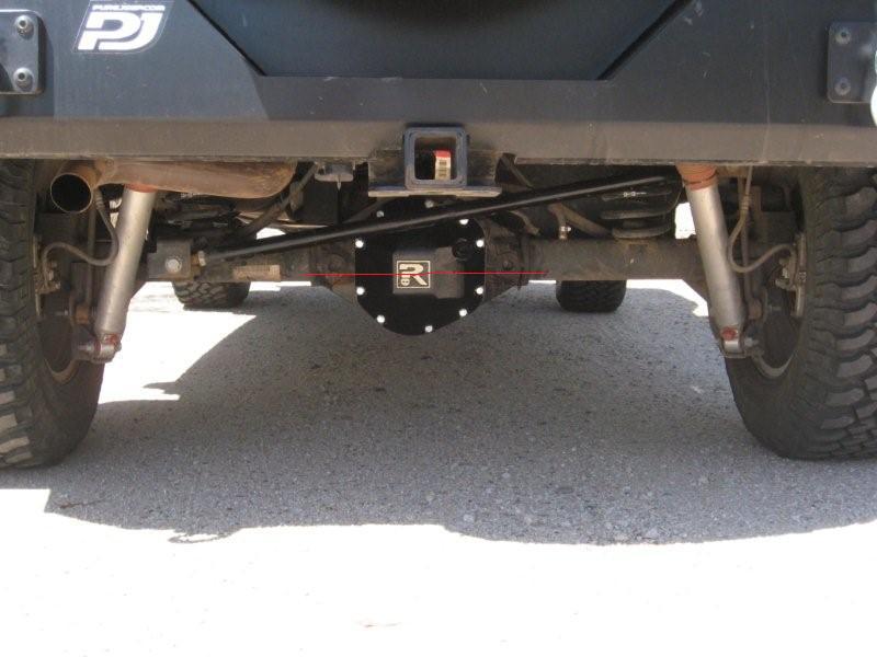

With aftermarket covers, filling exactly to factory specs may or may not be quite enough. Here's a rule somebody taught me a while back. Works every time.
With the truck on level ground, fill until the oil is level with the bottom of the inside of the axle. You can take a zip tie and bend it 90 degrees to use as a dip stick. Stick the zip tie into the fill hole up to the bend in the tie. Take it out and compare the oil level to where the axle lines up with the diff cover.
I modified the procedure just a little. I put in the factory recommended amount and check. If a bit low, I add only enough to make the dip-stick method work.
Name:	Riddler Rear with fill line.jpg
Something to keep in mind - if you put in an lift your rear pinion angle may change (depending on lift). You probably won't be able to fit the recommended factory amount in, especially with stock covers, unless you get creative - like jacking the right rear tire up a bunch or parking on a down-slope. You can use the method above to visually see how low the oil will be by comparing the plug hole to the axle.
That's why most after-market covers have a high fill hole.

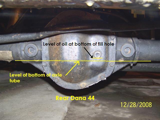

The red line in the picture above is about right. Here is a stock picture for comparison.
Whatever cover or angle you have, the oil level needs to be slightly above the level of the bottom of the axle tubes to permit oil to reach the outer axle bearings.
Name:	Rear Diff Oil Level.jpg
